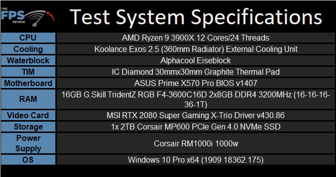

The above configuration is the general configuration of the test platform including the cooling hardware, which is something I get asked about a lot. Ambient temperatures were around 72-74F.

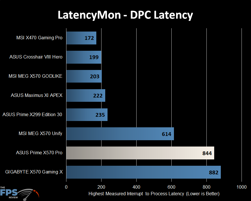

DPC Latency
For those who may not know what DPC is, I’ll explain. Deferred procedure calls are a function within Windows that allows higher priority tasks such as device drivers to defer lower priority tasks for execution at later times. It’s an interrupt and reassignment of sorts performed by the operating system.
DPC latency varies from board model to model and brand to brand. DPC issues show up in the form of audio dropouts and streaming video issues. Naturally, this is something that the enthusiast would want to avoid. I used LatencyMon and let it run for 10 minutes to graph the results. I have compiled a list of several systems I’ve tested over the last year and placed the results in a graph for easy reference.
When it comes to DPC latency, the ASUS PRIME X570 Pro sits below the threshold to have playback problems. I’d like to see lower DPC latency, but the X570 Pro is in line with everything I’ve seen lately regarding X570 motherboard chipsets. It never exceeded 844u during testing and generally sat far lower than this. The measurement is simply the worst latency recording during the test rather than the average. So, this represents the worst you would be likely to see from the PRIME X570 Pro. That said, your mileage can vary wildly on this.
