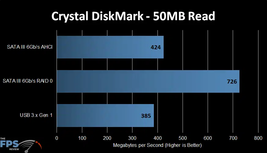

50MB Read Test Set
Here we saw solid results from the SATA controller and USB 3.2 controller in Gen1 mode. RAID performance was surprisingly excellent, this is due to the stripe sizes supported by the controller. Alternatives would potentially allow for a wider range of stripe sizes and optimization. Typically, the stripe sizes supported improve read times but sacrifice write speeds as you’ll see below.

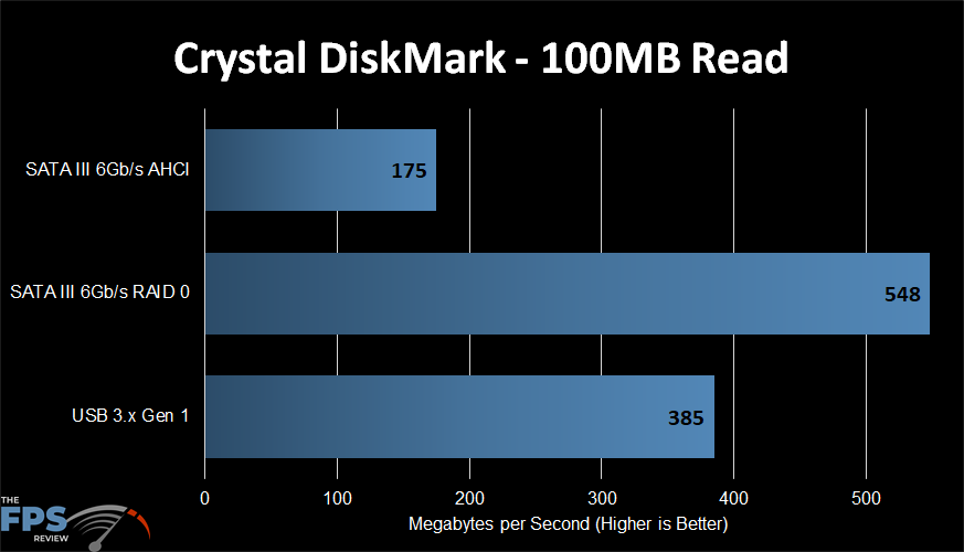

100MB Read Test Set
The 100MB read test set again showed outstanding results for the RAID 0 configuration. Oddly, it was more than twice as fast as the standalone AHCI test configuration was. USB 3.x was right on point.

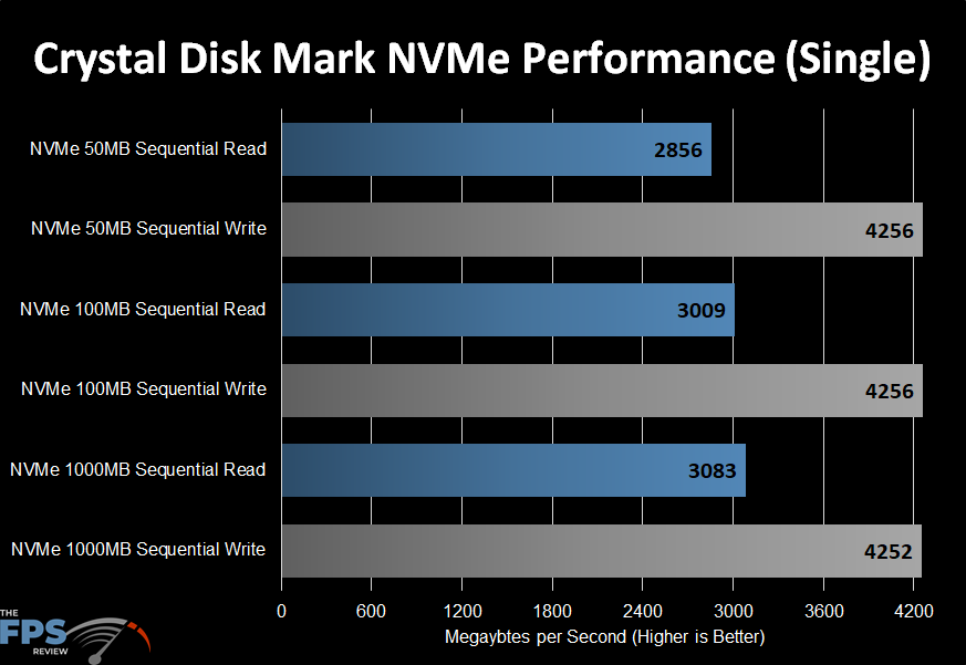

NVMe Drive Testing
The Corsair MP600 drive achieved solid results on the PRIME X570 Pro. The drive scores right around 2900-3100MB/s in the read tests and 4200MB/s+ in the writes. These numbers are exactly what we are used to seeing on other motherboards.
Again, the ASUS PRIME X570 Pro doesn’t support NVMe RAID, so there are no test results for that.
