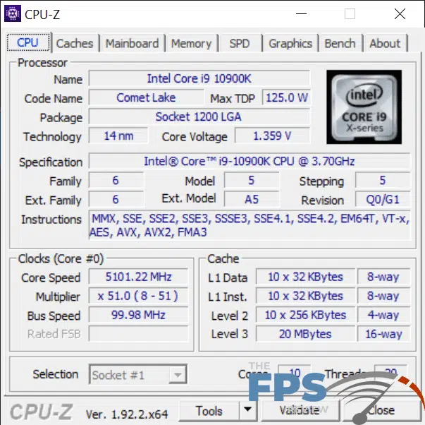

That’s precisely what we experienced with the ASUS ROG MAXIMUS XII EXTREME. Essentially, I only needed to adjust the CPU vCore and that was about it. Aside from that, I adjusted the CPU frequency multiplier, told it to apply to all cores and that was that.
As seen in the benchmarks, this resulted in an overclock of 5.1GHz all core. This was the maximum stable value I could achieve in the time allotted. Given the fine-tuning capability these boards offer, I’m sure I could squeeze out more if I had more time. The CPU runs too hot given the current-voltage of 1.4v. It would hit temperatures of 93c when loaded. This is just below idle. It might be possible to use less voltage after adjusting other values, but this is a time-consuming process of trial and error.
At 1.385v it was generally stable but crashed running BlenderBench. At 1.35v it was generally stable, but again, BlenderBench crashed it. I also saw the occasional crash in one or two other benchmark programs. VRM temperatures when overclocked read at 131-132F measured at the outside of the heat sink. It’s important to note that the heat does radiate over the I/O cover as it gets very hot. This means it’s conducting heat from the MOSFET coolers to the I/O panel cover as ASUS claims.
This is incredibly hot, but I’ve worse in the past. It’s also worth noting that it does get warmer in my office than it might for you given all the equipment I have running. Additionally, I had no airflow over the heat sinks which is a less than realistic scenario unless you are bad at building systems or something. In any case, these 14nm CPU’s are power-hungry and your VRM’s have to work fairly hard. We are seeing power draws almost like a 3950X overclocked with 6 fewer cores to give you an idea.

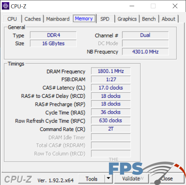

When it comes to memory clock, the ASUS ROG MAXIMUS XII EXTREME can handle anything you like. I only used 3600MHz Hynix modules, so they don’t clock very well. Essentially, 3603MHz was all I could get out of those. That said, if you have modules that clock well, you can do DDR4 5000MHz if your modules are good enough.
