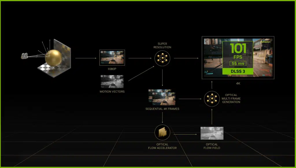

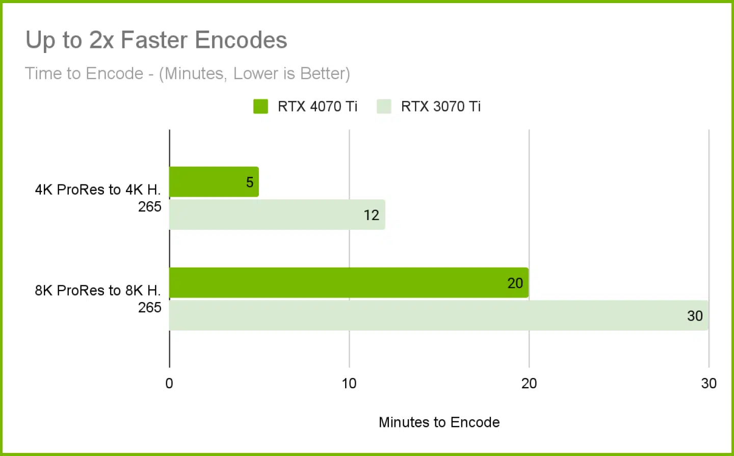

As with all other Ada Lovelace GPUs, it supports AV1 decoding and encoding and NVIDIA Broadcast.  It also supports DLSS 3 Frame Generation and NVIDIA Reflex.  The list of DLSS 3-supported games is growing.

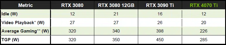

TGP450W320W285W
NVIDIA GeForce RTX 4070 Ti Power Table

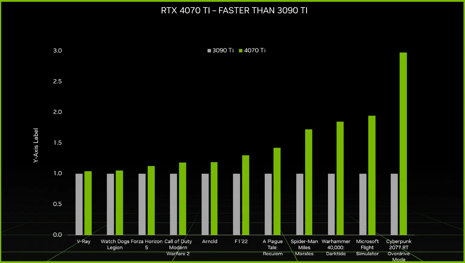

In terms of power, the GeForce RTX 4070 Ti should use even less power than a GeForce RTX 3080, yet perform at an RTX 3090 Ti or above.

DLSS3 itself isn't a real selling point. It exists, and it has a purpose - but not for most gaming scenarios. DLSS2 is still the main DLSS technology and remains more competitive overall, especially in situations where RT is used with heavy loads overall.

Well, it seems the card lies between the RTX3090 and 3090Ti, but men the thing gets bandwidh starved at 4k
I'm really impressed just becauese looking at the specs I really didn't think it would do that good.

I figured Nvidias "faster than 3090ti" claims were going to be all fluff, but it does at least get close most of the time, and actually succeeds in others.

Sure?
DLSS 1.0 was pretty bad - but showed the promise of intelligent upscaling.
DLSS 2.0 has more or less delivered on that promise. My opinion, of course; I find DLSS 2.0 to be more than close enough to justify any perceived degradation in visuals. Granted I have no problem using FSR / FSR 2.0 where exclusively available, whether I'm gaming on an AMD GPU or that's just what the game in question supports.
DLSS 3.0 is 'frame doubling'. This works great for pre-recorded media (if you like the effect itself), but for real-time applications it means that there's a definite insertion of additional input latency attached with usage. So, for DLSS 3.0 to even be useful in a particular situation, performance already has to be high enough for real-time interaction. Whereas DLSS 2.0 taking you from an arbitrary 20FPS to 35FPS, or 60FPS to 90FPS and so on can significantly impact the quality of the experience, DLSS 3.0 (that is, the 'frame generation' part of it) needs you to be running at 60FPS+ in the first place.
And there's a place for that - many games that aren't as user-response dependent can benefit, thinking anything turn-based or perhaps RPG and adventure-style games. Some simulators as well.
But for anything where optimizing for input latency is already a concern, DLSS 3.0 is a non-starter.
