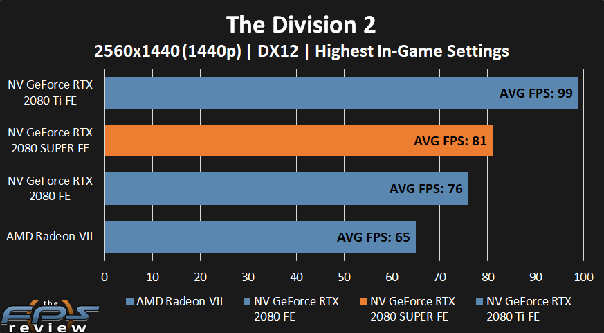

NVIDIA GeForce RTX 2080 SUPER The Division 2 Performance at 1440p
In the above graph we are comparing performance at 1440p.  Remember, the GeForce RTX 2080 SUPER is being compared to the Founders Edition of the GeForce RTX 2080, not the standard-clocked RTX 2080.  The Founders Edition has an overclocked boost clock compared to the standard-clocked RTX 2080.  NVIDIA states performance should be between 5-7% faster on the RTX 2080 SUPER versus the RTX 2080 Founders Edition.
In this test it looks like our RTX 2080 SUPER is 7% faster than the GeForce RTX 2080 Founders Edition.  This is right on point with the expected performance compared to this particular graphics card.  The GeForce RTX 2080 Ti still smokes it being 22% faster.  What the GeForce RTX 2080 SUPER is offering though is performance that is 7% faster for a price $100 less than the GeForce RTX 2080 Founders Edition.
At this resolution all video cards are technically playable at these settings.  However, the NVIDIA video cards are noticeably smoother and better with the higher frame rates compared to the Radeon VII.

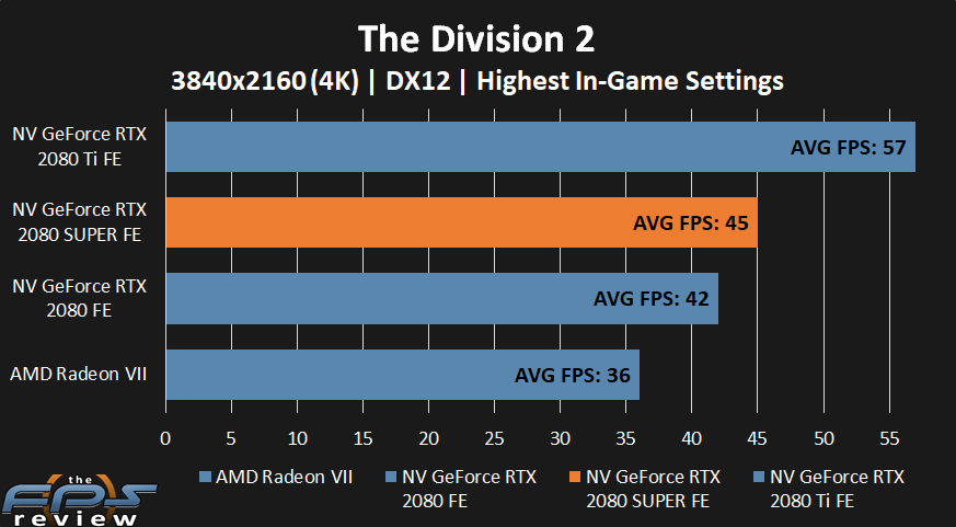

NVIDIA GeForce RTX 2080 SUPER The Division 2 Performance at 4k
4K really puts the hurt on all the video cards.  The Radeon VII suffers the worse.  Once again the GeForce RTX 2080 SUPER is 7% faster than the GeForce RTX 2080 FE, so it’s performing right where it should be.  The GeForce RTX 2080 Ti is 27% faster.  At this resolution only the GeForce RTX 2080 Ti at these highest settings is playable.  The other cards will have to drop in-game settings.
