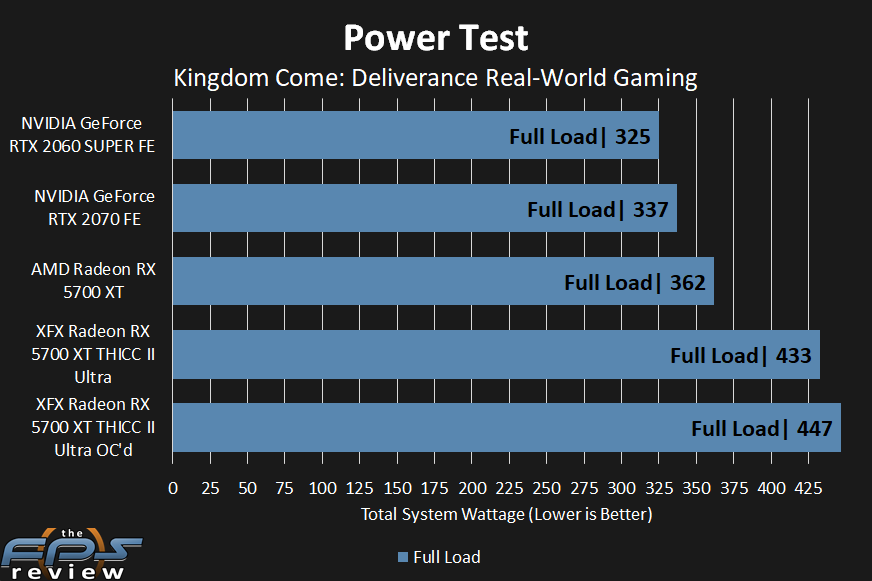

Naturally, the GeForce RTX 2060 SUPER FE has the lowest system wattage draw at 325W, it was also the slowest video card here. Next up is the GeForce RTX 2070 FE which only pulls 337W, not much more than the RTX 2060 SUPER. Generally, it was slower than the AMD Radeon RX 5700 XT GPU video card, but every now and then it was close to matching performance, at a lot less wattage. The GeForce RTX GPUs continue to be the most efficient.
The reference AMD Radeon RX 5700 XT pulls 362W. The XFX Radeon RX 5700 XT THICC II Ultra does pull a lot more wattage at 433W. That’s 20% more. However, it does so because it runs at a higher voltage, 1.200V versus 1.193V, and mainly because it has a higher TDP at 210W plus a factory overclock with much higher frequency. That causes it to consume about 20% more power for all those goodies. That does come with a slight performance boost though.
When we overclocked the video card (remember we can’t change voltage) it rose to 447W, a 3% power increase. This makes sense, we saw about a 3-4% performance bump from overclocking.
