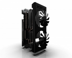

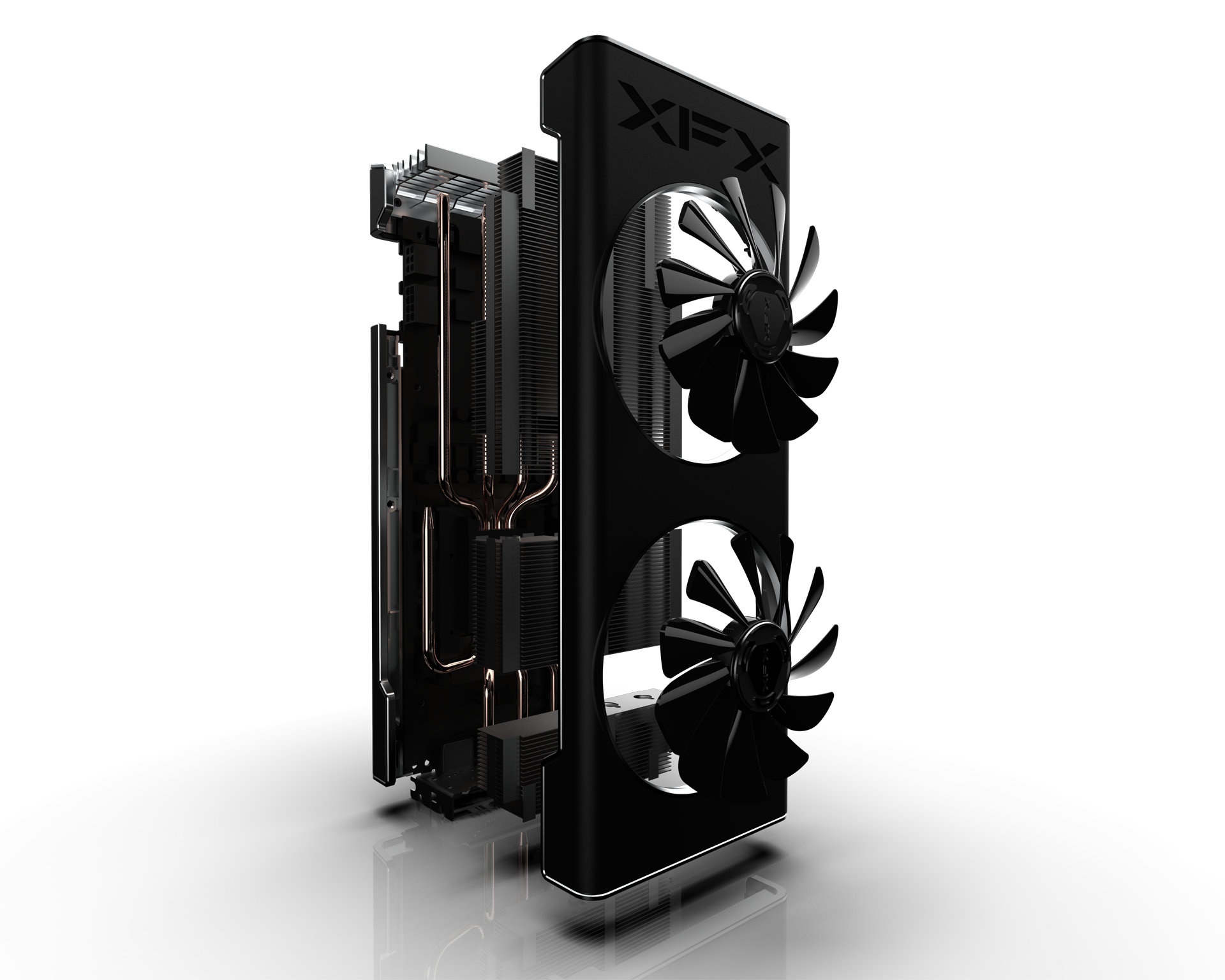

This video card is THICC at 11.54 inches long, 5.12 inches in width and 2.17 inches in height or thickness.  XFX calls this a “2.7 slot” thermal type video card. It requires 1×8 pin and 1×6 pin power connectors with a recommended PSU of 750W.  There are three Display Ports and one HDMI.

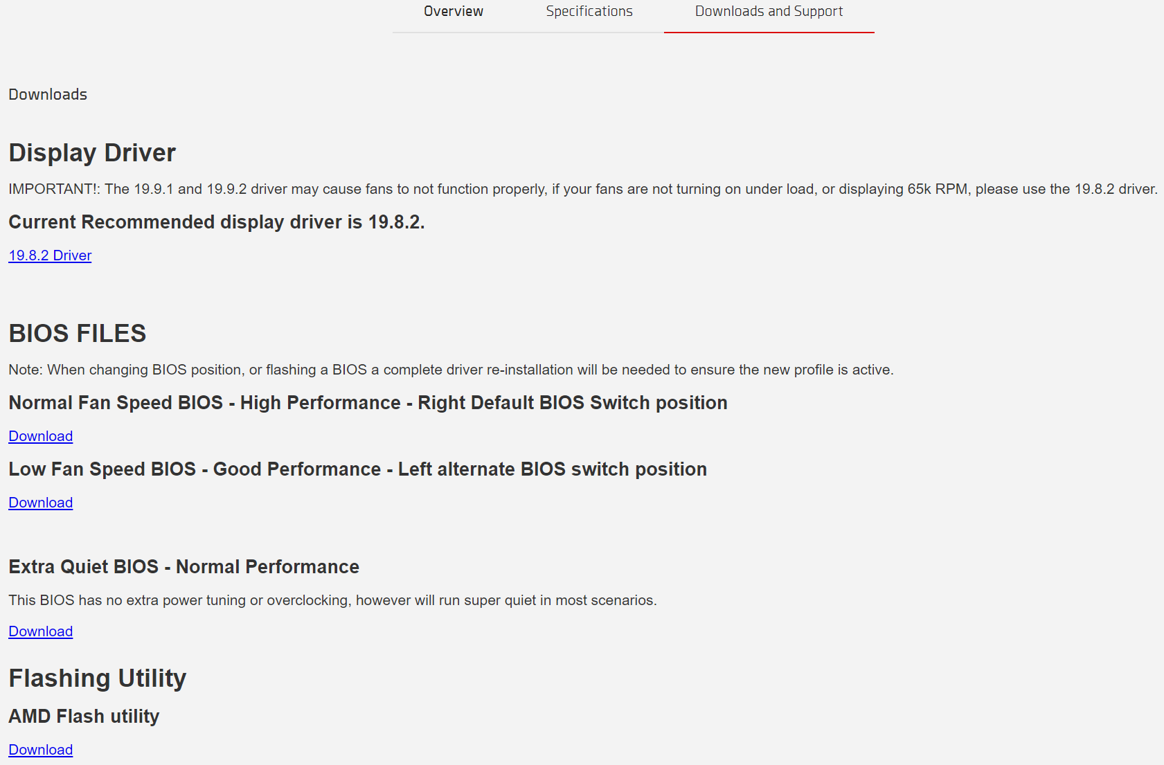

We are testing our video card today fully on the new fixed vBIOS sent to us directly from XFX.  The Performance BIOS we are using is labeled:”57XT821R.W8V1.”  XFX also sent us a new Quiet BIOS: “57XT8195L.W8T2.” So, we tested with the Performance BIOS throughout this review.  This is the 210W default BIOS with fixed profiles.  The fans worked as intended.
XFX has also put up the newest latest fixed vBIOS’s on their website under Downloads and Support.  If you buy a card, it can’t hurt to go ahead and flash the BIOS to the new updated BIOS.  For reference, when the switch is “toward the right” that’s the Performance position (which is the default position), and when the switch is “toward the left” that’s the Quiet Mode position.
