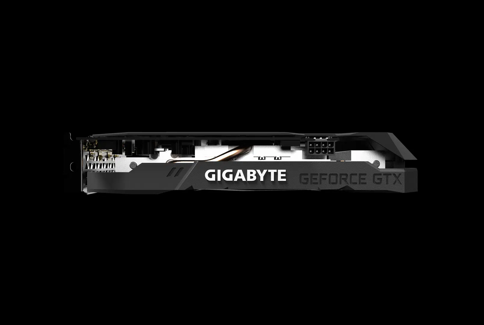

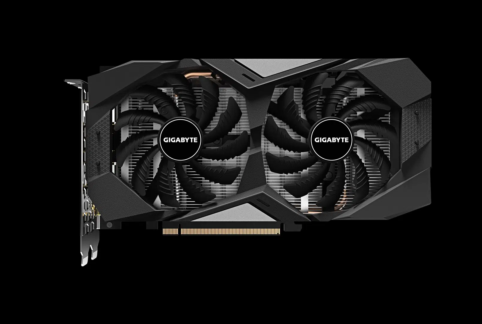

GIGABYTE has put its WINDFORCE 2x cooling system on this video card. This features 2x 90mm unique blade fans that spin in alternate directions. The fans also have triangular fan edge and air is guided smoothly through the 3D stripe curve on the fan surface enhancing the airflow. The fans also support 3D Active Fan so that they provide semi-passive cooling and remain off at lower temperatures or power demand.
There is a single large composite copper heat pipe that touches directly with the GPU. The heat pipe also covers the VRAM through a large metal plate contact to ensure cooling of the memory as well. The composite heat-pipe combines thermal conductivity and phase transition to manage heat transfer between two solid interfaces.

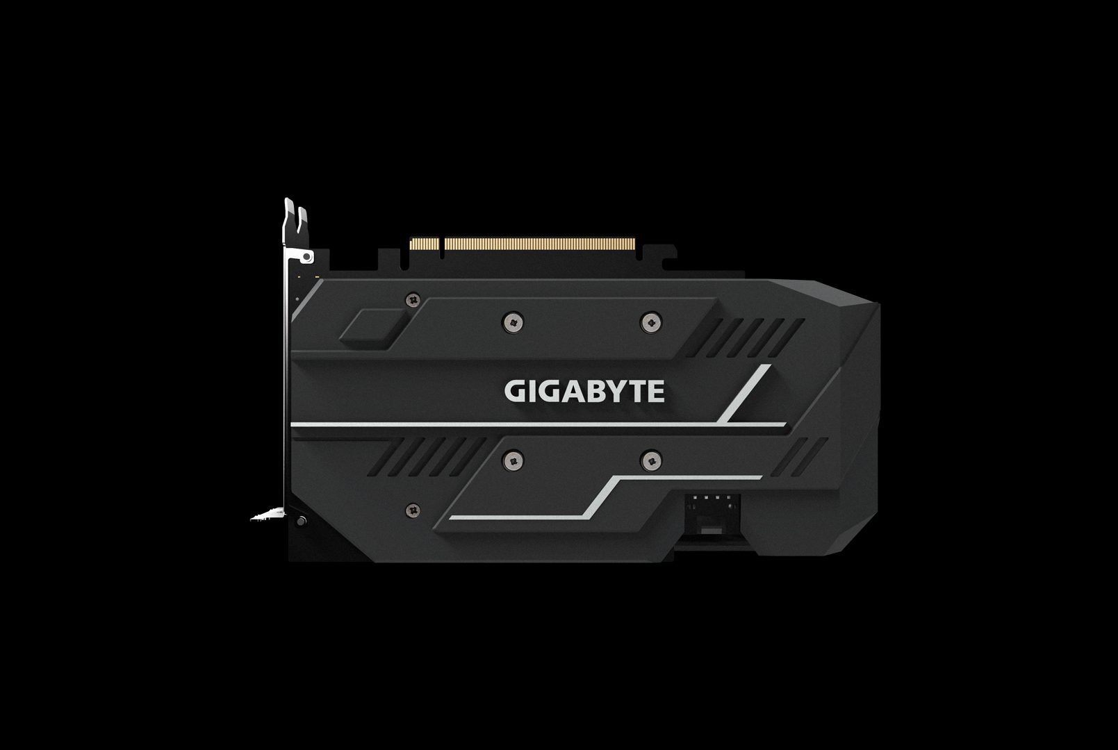

GIGABYTE uses its Ultra Durable VGA set of components on this video card to customize the PCB and components. This video card uses better power phases, 2oz Copper PCB, solid capacitor, and Ultra Durable certified chokes and capacitors. There is even a protection backplate installed to enhance the structure. You can utilize GIGABYTE’s Engine software for overclocking support with GPU voltage support and controls to turn the 3D Active Fan function off or on, for example, if you don’t want the fans to sleep at lower temps.

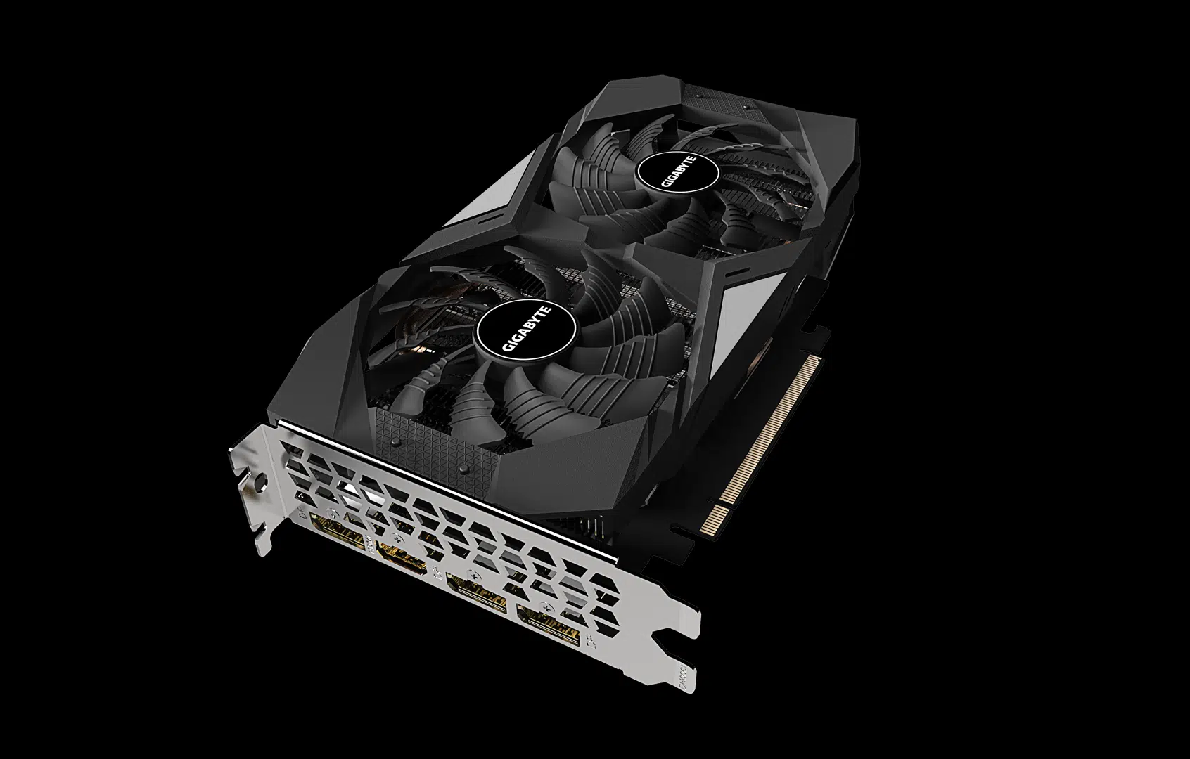

This video card does require 1 8-pin power connector. GIGABYTE recommends a 450W PSU. The video card has three DisplayPorts and one HDMI. Note that the specification sheet above is incorrect about the memory bandwidth, the memory bandwidth is 336GB/sec on this video card (14000 x (192/8)). The length of this video card is 8.8 inches long, width is 4.8 inches and the height is 1.5 inches. This is a compact video card.
