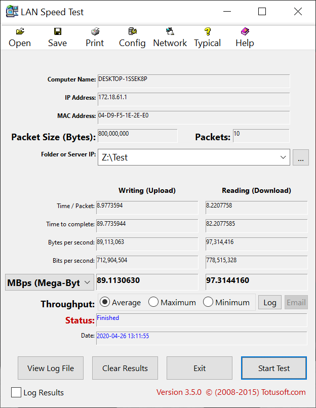

For its wired networking, the ASUS PRIME X570 Pro has an integrated Intel i211-AT network controller supporting 10/100/1000Mbps speeds.
The Intel i211-AT controller averaged 89.11MB/s in the write test and 97.31MB/s in the read test. The maximum transfer rates were 90.28MB/s in the write test and 104.53MB/s in the read or download test. The minimum transfer rates were 88.16MB/s in the write test and 61.36MB/s in the read test.
CPU utilization in the write test hung around 2%. There were some spikes here and there but overall it was level for most of the test. The CPU usage in the read test was also 2%. However, the usage was more consistent here.
